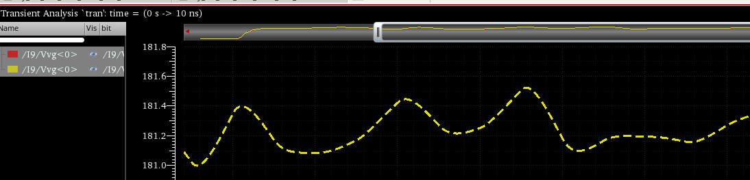

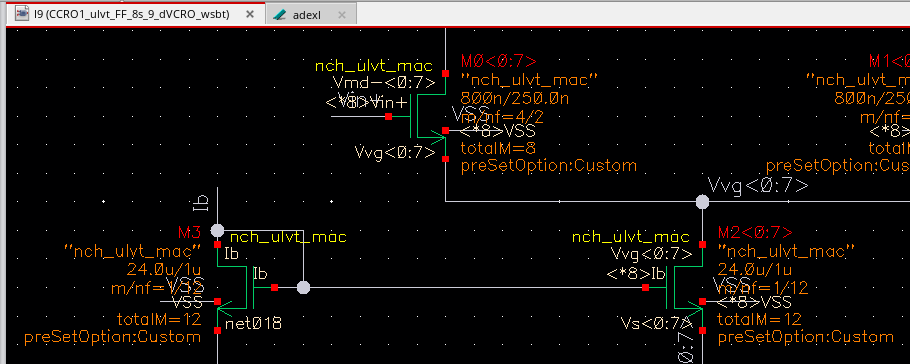

Hello! I used "noise contribution" function in tran to remove some noise source. In the following schematic, I wanted to disable the noise contribution of M3.
Then, I wrote "/I9/M3" in the Instance list.
To accelerate simulation, I chose APS. But after simulation, I found the wave of Vvg<0> was the same as not removing the noise contribution of M3 !

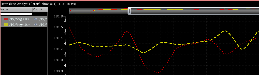

I think it is strange. I changed simulator from APS to spectre. Then the results were different.
But I am sure the noise contrituion indeed worked at previous APS simultions. It is my fisrt time to encounte this situation where noise contribution works in spectre but failed in APS.
