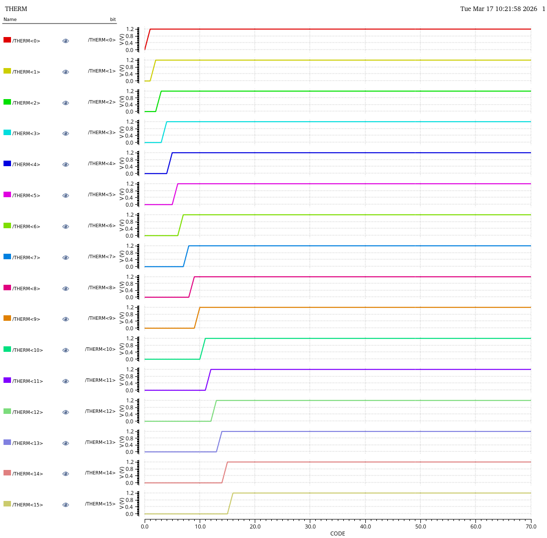

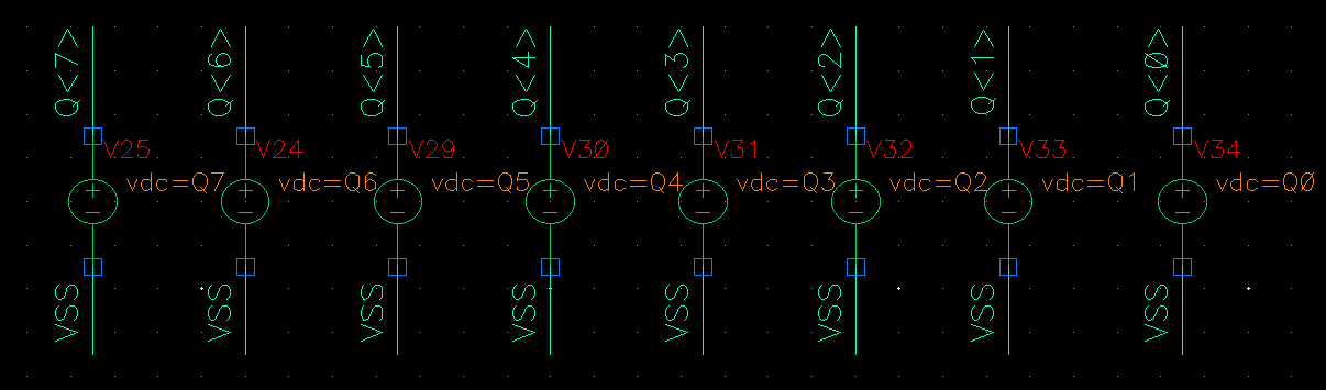

I need to do transient simulation for thermometer code input. Currently, I have 64 voltage sources and change the values one by one. I am sure there are other ways to do this efficiently. In short, I am looking for a way to pack these Q63 to Q0 as a design variable so I can sweep it using parametric analysis.
I am using ADE L and IC618.

    You might want to take a look at https://support.cadence.com/apex/ArticleAttachmentPortal?id=a1Od0000000nX1lEAE and https://support.cadence.com/apex/ArticleAttachmentPortal?id=a1O3w000009lnUWEAY (which show how to realize binary code).
    Andrew Beckett 7 months ago in reply to Frank Wiedmann
    A better solution (given that this is thermometer encoded) might be a simple VerilogA model. This will do what you want:
    // VerilogA for mylib, thermdc, veriloga
    `include "constants.vams"
    `include "disciplines.vams"
    `define thermMax 63
    module thermdc(out,ref);
    electrical [0:`thermMax] out;
    electrical ref;
    output [0:`thermMax] out;
    inout ref;
    parameter integer code=0;
    parameter vhi=1.2;
    parameter vlo=0.0;
    genvar bit;
    analog begin
      for (bit=0; bit<=`thermMax; bit=bit+1) begin
        if (code>bit)
          V(out[bit],ref) <+ vhi;
        else
          V(out[bit],ref) <+ vlo;
      end
    end
    endmodule
    You can then (when creating the view in Virtuoso) create a symbol. I then instantiated this, set a design variable on the code parameter (I called it CODE) and then swept that in ADE - here's part of the waveforms being shown (having problems uploading the image - will try a different route)
    Andrew Beckett 7 months ago in reply to Andrew Beckett
    Here's the plot:

    RA20250218276 7 months ago in reply to Andrew Beckett
    Exactly what I needed. Thank you.
