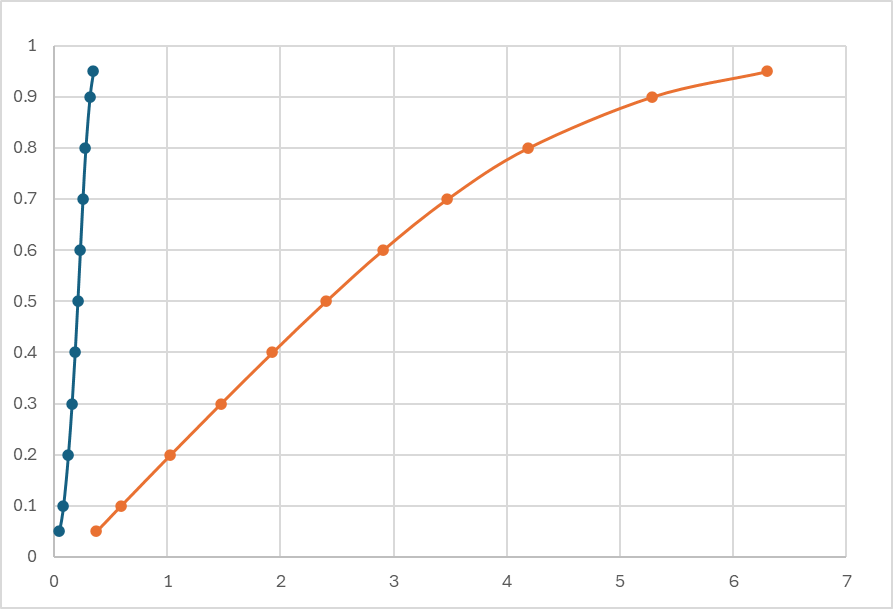

    ecsm_template_13 is just a name, which is not important. As you see in my example, I used ecsm_usr.
    in the ecsm delay group, values are the time points corresponding to the voltages in index_1. For example, with the delay_template_5x5, there are 25 slew/load cobinations, you will se 25 lines inside values table for ecsm,
    ecsm_waveform_set (ecsm_usr) {
    index_1 : "0.05, 0.1, 0.2, 0.3, 0.4, 0.5, 0.6, 0.7, 0.8, 0.9, 0.95";
    values : \
    line1 for first slew/load in delay_template_5x5
    line25 for last slew/load in delay_template_5x5
    With this you can plot V(out) vs Time as below for a small and larger loads, ie. line-1 & 5 in the example I use. So, using the input waveform(normallized waveform in the .lib), delay for each slew/load can then be measured.
    I hope this answers your questions.
    Guangjun
