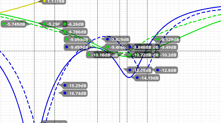

I am using plot templates in VIVa, however when I plot my waveforms, a large number of markers are automatically placed at each frequency point, which end up covering the waveforms themselves.
Currently, I have to move them manually one by one, which is very time-consuming. Is there a way to automatically reposition or hide the markers to avoid this overlap?

    Your plotting template appears to have lots of vertical and horizontal markers. You could either remove those and save the template again, or you could do:
    Marker->Select All
    Right Mouse menu (over one of the vertical or horizontal marker lines) -> Intercepts -> Off (or Off when Hover)
    That too could be saved into the template.
