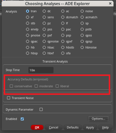

Hello community,
I've upgraded my spectre version from 23.1 to 25.1.
When I create a maestro view and add the new transient analysis, so in the analysis I can't able to select Accuracy Defaults (conservation, moderate and liberal)..!!
So my question, is that a spectre 25.1 tool issue or something else..? (In spectre 23.1 I can able to select Accuracy Defaults.)
Look into in below snapshot of spectre 25.1. The Accuracy Defaults is disable kind of thing.
- Viraj.
    Andrew Beckett 3 months ago
    Viraj,
    From IC25.1 the default is Spectre X (set on the High Performance Options form under the Setup menu). Usually the accuracy settings are then controlled using the performance level (cx, ax, mx, lx, vx). This can be overridden if needed via the preset override (although I wouldn’t do that for errpreset), or you can change the high performance mode back to APS or Spectre if needed.
