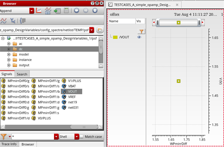

When I run a simulation from ADE, I can see in VIVA a wave for each net, even if the simulation is a DC without sweep.

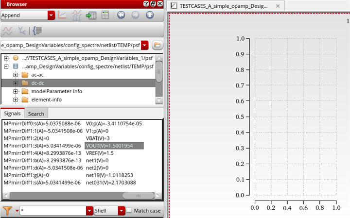

If I run the simulation file runSimulation from the directory netlist created by ADE, in VIVA each net is a scalar now and can not be plotted
Any reason for that? What makes the creation of wave rather than a scalar?
Laurent.
    Andrew Beckett 3 months ago
    Laurent,
    This is because in the top one you are using the results browser for the entire set of simulations (you might only be running one, but ADE could allow multiple runs because of sweeps or corners). In other words, you're looking at the psf/testName/psf dir rather than (e.g. 1/testName/psf dir - the number being one of the points). If you go over one of the output cells in the ADE results and do Right Mouse->Results Browser it would open the specific point only and then you should see what you are seeing in the bottom ViVA.

  • kkdesbois
    kkdesbois 3 months ago in reply to Andrew Beckett
    Thanks Andrew.
    While you were answering, I realized my mistake and misunderstanding.
    ExporerRun0/psf/testName/psf : the nets are saved as waves
    ExporerRun0/1/testName/psf : the nets are saved as scalars
    And of course when I RMB->Open Terminal and launch runSimulation, I re-create this ExporerRun0/1/testName/psf (i.e, scalar).

    Andrew Beckett 3 months ago in reply to kkdesbois
    It's not really that the nets are saved as waves for psf/testName/psf. What happens is that for the psf/testName/psf dir, ADE creates a runObjFile which collates the individual point results together as a family, and hence when opening that you get waveforms instead (because there might be more than one point simulated and even with a single point it's a waveform of one point).
