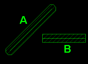

I am trying debug a skill script which involves finding abutting shapes.
lpp = selectedObj~>lpp
bbox = selectedObj~>bBox
overlaps = dbGetTrueOverlaps(cv bbox lpp 0)
I found that shapes with diagonals don't work well. With object 'A' selected it returns 'B' as overlapping but not the other way round.
Is there an alternative that will cope with this situation? The script is meant to return the total length of a path.

    Andrew Beckett 26 days ago in reply to RC202602061219
    I meant to reply to this but obviously got distracted whilst doing so!
    Anyway, the mains ways of doing this are to do one of:
    1. dbLayerAnd of the shapes as you've done (you could use dbOpenScratchDesign as that doesn't require anything on disk))
    2. dbPolntArrayAnd - you could get the boundary of the pathSeg using obj~>boundary or if it was a path you'd use dbGetPathBoundary. For other shapes you'd have to compute them yourself
    3. abeLayerAnd - you can construct the ABE shapes from the original shapes and then the and is just done in memory. Note that these are constrained to 45-degree shapes (OK in this case)
    4. You could iterate over the points in one shape and use geIsPointInsidePolygon or leIsPointInsideFig - again you need to find the boundary. There's also abPointInPolygon in this post if you are in a context (e.g. in a PCell) that can't use ge or le functions.
