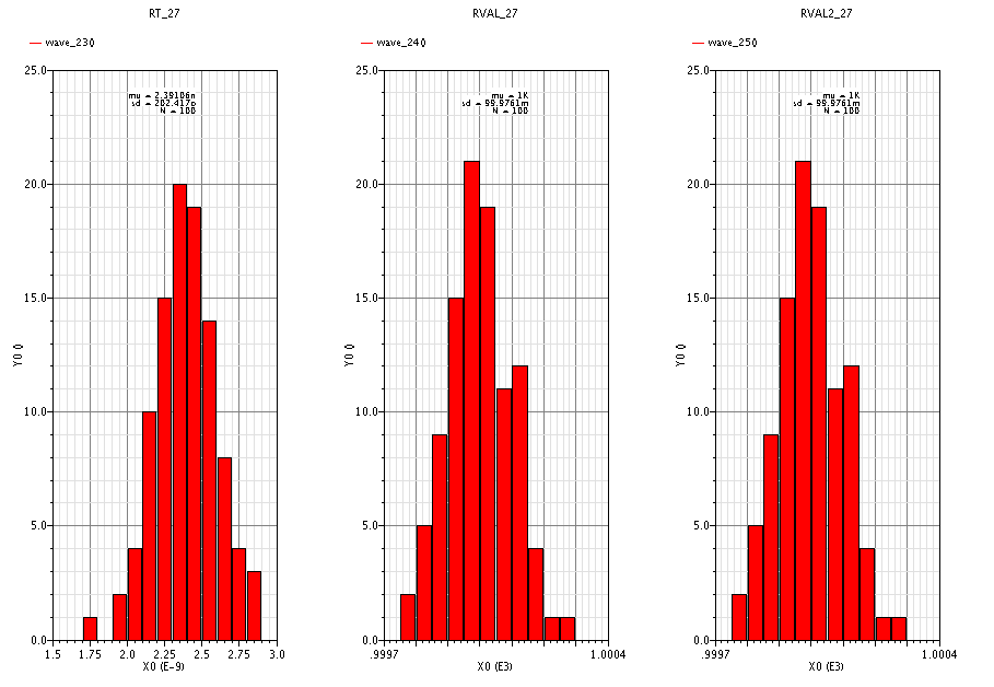

    Here's a very simple OCEAN script I have using VAR and pv() approaches:
    ocnWaveformTool( 'wavescan )
    simulator( 'spectre )
    design( "/export/home/users/andrewb/simulation/rcac/spectre/schematic/netlist/netlist")
    resultsDir( "/export/home/users/andrewb/simulation/rcac/spectre/schematic" )
    path( "./models" )
    modelFile(
    '("res.scs" "")
    analysis('tran ?stop "100n" )
    desVar( "sup" 3 )
    desVar( "rval" 1k )
    desVar( "cval" 1p )
    temp( 27 )
    monteCarlo( ?numIters "100" ?startIter "1"
    ?analysisVariation 'process ?sweptParam "None"
    ?sweptParamVals "27" ?saveData nil
    ?nomRun "yes" ?append nil
    ?saveProcessParams t
    ?samplingMethod 'LHS)
    monteExpr( "RT" "riseTime(clip(VT(\"/net5\") 8e-09 1e-07) 0 nil VAR(\"sup\") nil 10 90 nil \"time\" nil nil)" )
    monteExpr( "RVAL" "VAR(\"rval\")" )
    monteExpr( "RVAL2" "pv(\"top-level\" \"rval\" ?result 'designParamVals)" )
    monteRun()
    Both work. In this case I have the variable "sup" (which is constant) which is used within the RT measure. Then I have rval (which has a statistical distribution on it, inside the res.scs model file). You can see two different ways of accessing that variable, with VAR and pv(). Both give a distribution as in the attached picture.
    The pv function is definitely covered in the OCEAN Reference manual (chapter 7, Data Access Commands in IC5141). Didn't check the VAR() function, but it corresponds to the var button in the info tab (in wavescan calculator), or the var button in the AWD calculator.
    Andrew Beckett over 16 years ago
    In my web browser, the attachment picture in the last post is chopped off and only shows two out of the three subwindows - if you click on the attachment name though you'll see all three monteExpr histograms.
