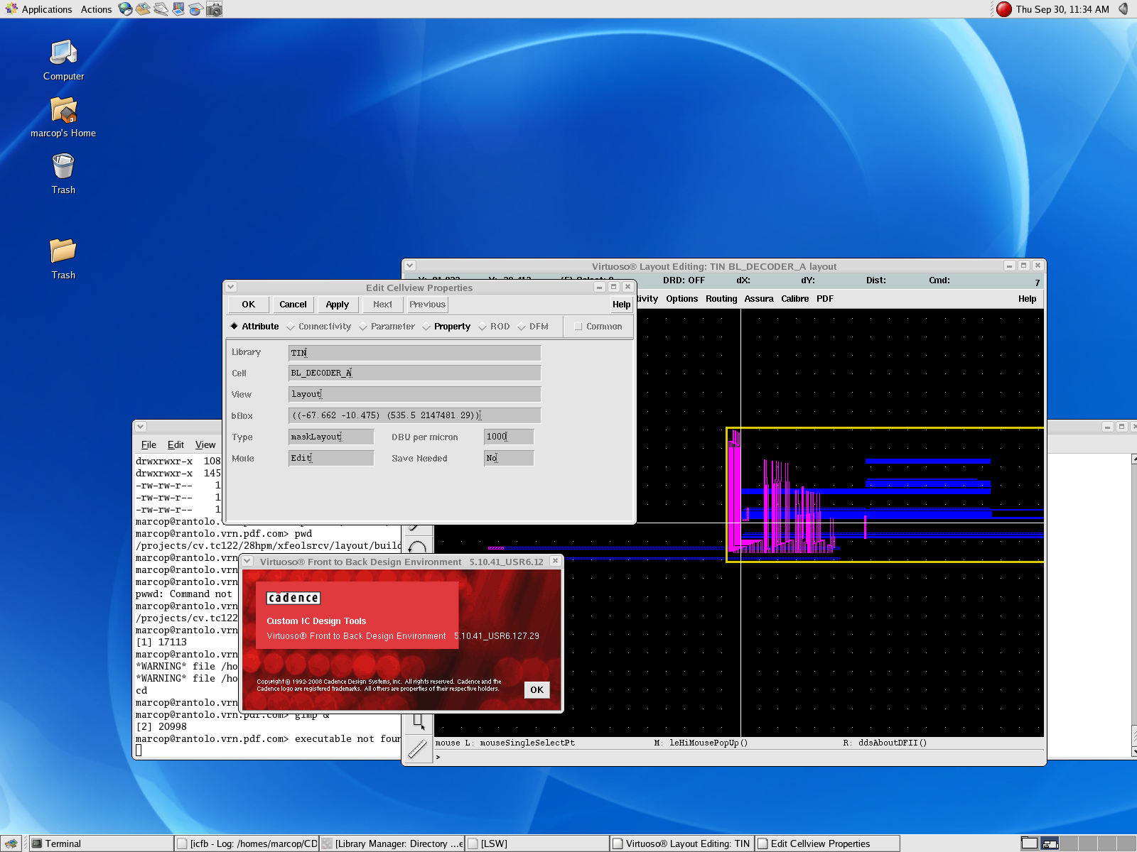

 Hi all,
I'm using icfb 5.10.41_URS6.127.29 and sometimes the bBox dimension doesn't match with real layout dimension. I fixed the problem drawing by hand a very big rectangle shape that forced the layout to recalculate the bBox. After that I deleted this rectangle shape and the bBox mathed with real layout dimensions.
Yesterday the bBox went in "overflow" with coordinates ((-2 -2146015.87) (672.296 3091)) and the layout "disappears". I tried to export GDS and it is correct, so the problem is only on graphic display.
I tried to run icfb, layout, on 32 and 64bit red-hat linux machine but the problem may or may not happens
Is there a cadence version that fix the bBox problems?
 Thanks and regards,
Marco

    Quek over 15 years ago
    Hi Marco
    If the problem can be reproduced, would you please submit a testcase to Cadence support so that we can fix the bug?
    Thanks
    Quek

    marcop over 15 years ago
    Hi Quek,
    I submit the test case to you because I don't know how to send it from cadence web-site.
    In attached files, the screenshot shows the bBox huge value and tgz file is the cell that has the problem. I hope that when you will open it, the problem will be present.
    Thanks
    Marco
    Hi Marco
    Thanks for the screenshot. I don't seem to see any tgz file in your post. For your information, you can either email the file to europe_crc@cadence.com or use our support website.
    Best regards
    Quek
