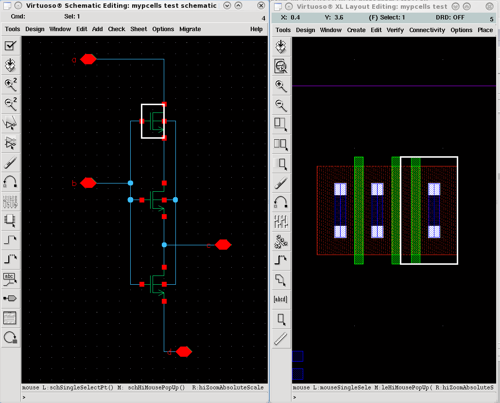

    I just tried this in IC5141, and it worked for me there too. Here's what I did:
    1. Created myself a library (compiled using the same tech file as gpdk090 - but that doesn't matter too much).
    2. Loaded the sample pcell code:
      setSkillPath(prependInstallPath("samples/ROD/rodPcells"))
      load("install/spcLoadInstall.il")
    3. Picked the Sample Pcells->Install menu in the CIW, and filled things in. Just enabled the simple mos devices, and completed a few missing layers and rules.
    4. Copied nmos4/symbol from analogLib to mypcells/spcsimple_nmos/symbol
    5. Created a simple schematic with some series connected devices (I assume you did this, because it needs to know that to understand how they are abutted).
    6. Started layout XL
    7. Did a gen from source
    8. Moved the instances around so the source/drains overlapped and watched them about.
    In the attached picture, you'll see that two of the devices have a shared source drain with no third connection, and one has a pin too - so the metal will remain. I've cross-selected between the schematic and layout so you can see which device is which.
