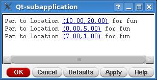

I wrote a piece of code that generates a logfile containing some error points referred to a Layout. Is there a way to create a log file (HTML???) where I can click on the points for generating an actions such as, for example, the point higlithting on layout?

    Here is one way to do it with the hypertext field on a form.
    x1 = 10.0
    y1 = 20.0
    x2 = 0.0
    y2 = 5.0
    x3 = 7.0
    y3 = 1.0
    sprintf(content "\tPan to location <a NAME=myname href=#myloc|pan|%.2f|%.2f>(%.2f,%.2f)</a> for fun\n" x1 y1 x1 y1)
    sprintf(content "%s\tPan to location <a NAME=myname href=#myloc|pan|%.2f|%.2f>(%.2f,%.2f)</a> for fun\n" content x2 y2 x2 y2)
    sprintf(content "%s\tPan to location <a NAME=myname href=#myloc|pan|%.2f|%.2f>(%.2f,%.2f)</a> for fun\n" content x3 y3 x3 y3)
    procedure(myCb(fieldSym hyperName hyperRef)
      let((data x y)
        data = parseString(hyperRef "|")
        when(cadr(data)=="pan"
            x=evalstring(nth(2 data))
            y=evalstring(nth(3 data))
            hiPan(hiGetCurrentWindow() x:y)
    ) ;proc
    _myZoomForm= hiCreateAppForm(
        ?name '_myZoomForm
        ?fields list(
          list(hiCreateHypertextField(
            ?name 'zoomHyperWin
            ?value content
            ?hasHorizontalScrollbar t
            ?hasVerticalScrollbar nil
            ?callback "myCb"
           ) 0:0 300:100
    hiDisplayForm(_myZoomForm)
