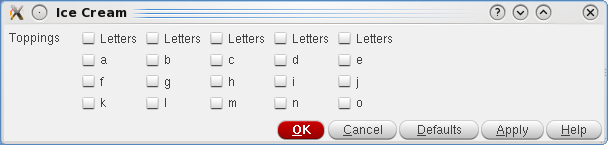

    What are you asking here? When you run your code, you get:
    Apart from this being a bit odd, it's not clear to me what it is you wish to get that is different from the above picture?

    gs748 over 11 years ago
    Hi Andrew,
    Like below, I would like to have a check box for each line and display format should align with a tabular form. Thanks for your help here!
    Checkbox Letters Letters Letters Letters Letters
    Checkbox a b c d e
    Checkbox f g h i j
    Checkbox k l m n o
    If you only want a single checkbox per row, I would put a toggle field to the left of a report field (or four boolean buttons left of a report field).
