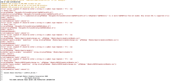

After doing an update to the new pdk I get the following error. I think It comes from my .csinit file. It is asking about the EV variable of GF_PDK_HOME not being set.
And many other errors that come from the .cdsinit.
Please see attached.
Thank you always.
    Haven't you answered your own question? It sounds as if it's expecting the UNIX $GF_PDK_HOME to be set to the location of the PDK (I assume). Because that's not set, the SKILL variable gfPdkHome is nil, which results in all those SKILL errors.

    Hello Andrew,
    Thank you for your prompt response.  I have set the environment variable and still coming up with an error.
    I have attached my .cdsinit and the new error screen shot.
    Thank you always for your help. my_cdsinit.docx

    I want to put the envirnonemt variable in my .cdsinit file. I did:
    setShellEnvVar("GF_PDK_HOME=/home/grps/ef-test/GLF8HP/130HPSIGE-8HP/")
    And in CIW when do:   getShellEnvVar("GF_PDK_HOME") It still comes back nil
    I am getting the same error messages as before. I don't know what I am doing wrong.

    Andrew Beckett over 7 years ago in reply to wgtkan
    Please pay careful attention to what we're saying. You changed the first line to:
    if(gfPdkHome = getShellEnvVar("GF_PDK_HOME=/home/grps/ef-test/GLF8HP/130HPSIGE-8HP/") then
    You're mixing the setShellEnvVar with getShellEnvVar - the getShellEnvVar call you've specified makes no sense.
    This should be:
    if(gfPdkHome = getShellEnvVar("GF_PDK_HOME") then
    I suggest you either set GF_PDK_HOME before you start virtuoso as mentioned before, or add another line before the lines above:
    That will set it, and then the getShellEnvVar("GF_PDK_HOME") will get the variable value.

    mbracht over 7 years ago in reply to wgtkan
    look at your .cdsinit above - you do not(!!) issue a setShellEnvVar(..) - you do
    if(gfPdkHome = getShellEnvVar("GF_PDK_HOME=/home/grps/ef-test/GLF8HP/130HPSIGE-8HP/") then...
    it is supposed to be:
    And better yet you set it in the bash ever before you launch virtuoso
