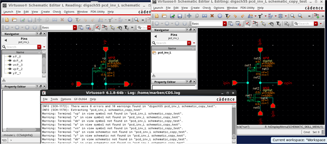

How to copy selected objects from the current schematic window to other schematic window
using SKILL?
I used the following code to copy selected objects in the layout window to other layout window,
it works perfectly. But when I used it to copy selected oblects from the schematic to other
schematic window, there are errors created in the new schematic window, please see the picture below.
Please help.

    Hi Marben,
    Do Check->Current CellView (typically the "x" bindkey) or File->Check and Save (typically shift-X) after doing the copy.
    The issue is that the cdsTerm labels on the transistor symbols can't display the nets because the nets do not get partially extracted after a copy using SKILL and the internal database has not been synchronised. So a better solution might be to change the code as follows (small change in abCopyToOtherWinCB):

    Hi Andrew,
    It almost works.
    All errors display in the copied window is gone.
    There is only one more problem.
    The pin net name is not copied.
    There must be something like "VP", "a" , "y" . . .etc in the target schematic window to which selected objects is to be copied,
    not " ipin", ipin" "opin" .
    Best regards,
    Marben
    Andrew Beckett over 7 years ago in reply to Marben
    Hi Marben,
    Whoops! I didn't notice that. Not surprising, because dbCopyFig is only going to copy the figure and not the pin. So I changed the code a little to use schCopy instead when it's a schematic, which should handle the more complex objects. This seems to work:

    Marben over 7 years ago in reply to Andrew Beckett
    Hi Andrew,
    It is now working perfectly.
    Thank you very much.
