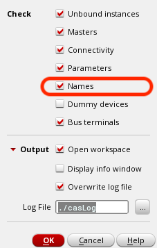

    First use Connectivity->Check->Against Source:

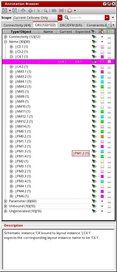

    Then in the Annotation Browser you'll see in the CAS tab the Names which don't match:

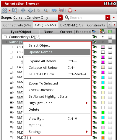

    Then go over the Names heading (or individual mismatches) and use Right Mouse->Update Names:
    That will fix the names to match the expected name.
