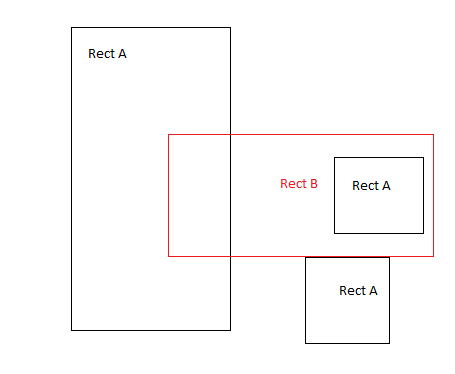

Dear all,
I'm new beginner. I want to compare 2 locations each other. Please help me on this.
Thanks a lot.
Example:
location A = ((0.00075 0.00525) (0.01025 0.00875))
location B = ((0.0125 0.00475) (0.0155 0.00775))
if location A in location B ==> pass
if location A not in location B ==> fail

    Phuong Truong over 6 years ago
    Dear all,
    I am a new beginner. I want to check if a coordinate of rectangle A is on rectangle B.
    Have any simple example code for this? Any help is appreciated.
    Thanks a lot.
    Example:
    Rectangle A : ((1 2) (3 4))
    Rectangle B: ((2 2) (5 6))
    If coordinate of rectangle A is on rectangle B is pass.
    Andrew Beckett over 6 years ago in reply to Phuong Truong
    I merged your duplicate questions together to avoid confusion (the first one was not very clearly asked). What do you mean by "on"? Do you mean they overlap? Or do y ou mean that rectangle A is entirely inside B?
    Anyway, these two functions do what you want (I think - you should double check my logic as I threw this together and didn't check it thoroughly):
    procedure(CCFrectOverlap(rectA rectB)
      destructuringBind(((Allx Ally) (Aurx Aury)) rectA
        destructuringBind(((Bllx Blly) (Burx Bury)) rectB
          (Allx>=Bllx && Ally>=Blly && Allx<=Burx && Ally<=Bury) ||
          (Aurx>=Bllx && Aury>=Blly && Aurx<=Burx && Aury<=Bury)
    procedure(CCFrectInside(rectA rectB)
          (Allx>=Bllx && Ally>=Blly && Allx<=Burx && Ally<=Bury) &&
  • Phuong Truong
    Phuong Truong over 6 years ago in reply to Andrew Beckett
    Hi Andrew,
    Thanks so much for your reply.
    I mean that rectangle A is entirely inside rectangle B or a part or an edges of rectangle B.
