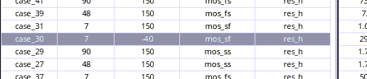

How to get the current selected corner in ADEXL in Detail-Transpose mode.
hxall
hxall over 6 years ago
Hello, does anyone know how to get the current selected corner in ADEXL in "Detail-Transpose"? like the picture showed below. what is the skill function, I search the support and manual, just can't find it. Thanks.

    You can't as such but it may be there's an alternative way of doing what you want (e.g. adding a custom menu which accesses the data for that simulation point). What are you trying to do?

    Thanks Andrew. I am trying to open the simulation result on that selected corner automatically

    What do you mean by "open the simulation result"?

    something like openResults(".../simulation/tb_gd/adexl_dc/results/data/Interactive.0/31/sim:tb_gd:1/psf")

    One thing you could do is to create a directory called menus (in the working dir, or somewhere else in the "setup.loc" locations - see the documentation on the Cadence Search File mechanism), and within that place a file called spectre.menus with this content:
    CCFStdSpectreMenus=sevCustomEntity('sevItemListsCME)
    (sevAddMenuItemLists
      (lambda (session name)
        (case name
          ; Add new Open Results entry in Results menu
          (("Results" "&Results")
           (append1
    	 (funcall CCFStdSpectreMenus session name)
    	 `("Open Results"
    	   ?callback (openResults (asiGetPsfDir (sevEnvironment ',session)))
    	   ?disable (sevNoResults ',session))
    Then in ADE XL/Explorer/Assembler you can use the Right Mouse button menu over a simulation point and pick "Open Results" and it will invoke openResults() for that point, so typing in the CIW would allow you to call results(), or v("/blah" ?result 'tran) and it will work with that set of data.
    Hope that helps?

    Thanks Andrew for your quick support! Works great!
