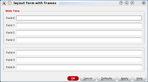

    Andrew Beckett over 6 years ago in reply to Aldo2
    Hi Aldo,
    Frames are still available, but created a different way. You use the ?frame argument to the functions that create a layout (i.e the functions that match this pattern: ^hiCreate.*Layout$). Since you can nest layouts within other layouts, you can effectively create your own widgets this way or implement frames as before. So this code:
    procedure(abCreateFrameLayoutFields(startNum endNum)
        let((fields field label)
            for(i startNum endNum
                field=hiCreateStringField(?name concat('myfield i))
                label=hiCreateLabel(?name concat('label i) ?labelText
                    sprintf(nil "Field %d" i)
                fields=tconc(fields list(label 'row i 'col 0))
                fields=tconc(fields list(field 'row i 'col 1))
            fields=tconc(fields list('col_stretch 0 0))
            fields=tconc(fields list('col_stretch 1 1))
            fields=car(fields)
    procedure(abCreateFrameLayoutForm()
        let((fields frameLay1 frameLay2)
            fields=abCreateFrameLayoutFields(0 3)
            frameLay1=hiCreateGridLayout(
                'frameLay1
                ?items fields
                ?frame "With Title"
            fields=abCreateFrameLayoutFields(4 6)
            frameLay2=hiCreateGridLayout(
                'frameLay2
                ?items fields
                ?frame t ; no title
            hiCreateLayoutForm(
                'abFrameLayoutForm
                "layout form with frames"
                ; Add a stretchable region below the grid so that
                ; the fields don't spread out vertically
                hiCreateVerticalBoxLayout(
                    'vbox
                    ?items list(
                        frameLay1
                        frameLay2
                        list('stretch_item 1)
                ?minSize 600:200
    hiDisplayForm(abCreateFrameLayoutForm())
    produces this:
