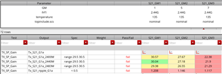

Is it possible to specify the "Spec" based on the corner setup? Is there an easy solution here?
What I would like to have specify the "Spec" something like, if GM==1 then 30 elseif GM==5 then 27 else 22.
I know I can create separate tests for different corners and specify the "Spec" for each one differently. But, I am looking for something other than this.
Thanks a lot in advance.
    You can go over the specification and use Right Mouse->Override Specifications which allows you to set different specs for different corners.
    Does that do what you want?
  • amitG22
    amitG22 over 5 years ago in reply to Andrew Beckett
    Yes that is what I was looking for. Thanks a lot.
