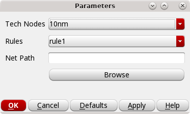

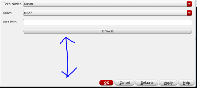

Hey,
Can anyone guide me on using vertical/horizontal spacers as when I am selecting the option "60"nm from combo box, group box gets to disappear but is created void gap in GUI? How to remove that void gap..also when am stretching GUI..boxes is not stretching and  remains in their original shape...pls guide am newbie to this.

    If you want fields to resize, and spacing to adjust as you alter the visibility, you really need to use the newer "layout" forms rather than coordinate-based forms (layout forms were newly added in IC617…
    If you want fields to resize, and spacing to adjust as you alter the visibility, you really need to use the newer "layout" forms rather than coordinate-based forms (layout forms were newly added in IC617). As usual, your code doesn't run properly (the hiDisplayForm is outside of the let, so the rulesTable is no longer in scope, and the callback is trying to access a field on the form that doesn't exist any more) - it also doesn't reflect the picture you shared.
    Nevertheless, I've given you an example here of using a simple layout form. I'm using hiCreateFormLayout as this is simple - it doesn't however give you the ability to have multiple columns - if you wanted that, you'd need to use hiCreateGridLayout (search on these forums for an example using that) - that would complicate matters as you really need to create separate labels rather than using the built-in prompts in the fields otherwise the fields don't line up nicely.
    A key change I also had to make was to move the rulesTable into the callback function; this is because the form layouts are non-blocking, so the callback would not be able to see a local variable within the Switches function as it is no longer in scope at the time the callback is invoked.
    Hope this helps - I invented some more conditions to show fields becoming visible/invisible to show the principles (I also put the fields into a let at the top so that you weren't creating global variables all over the place).

    Andrew Beckett over 5 years ago in reply to saurabh96
    Two things here:
    1. Layouts (such as Grid layouts) are supported within hiCreateLayoutForm, not hiCreateAppForm. Essentially you change the top level form creation to include a layout, and then layouts can be nested within other layouts - see the example I gave earlier in this thread and also that I linked to to show how to do it for a lib/cell/view/browse based example. The idea is that with layout forms you have an in-built geometry management capability and specifying coordinates would be counter to that
    2. Frame fields are not supported with hiLayouts. I just realised that the internal spec made this clear, but I don't think the documentation does. I'll get that corrected. It's unnecessary because each of the layout creation functions (such as hiCreateFormLayout, hiCreateGridLayout) allow you to specify a frame around that layout using the ?frame argument. This is a much more elegant way of doing it rather than creating a frame box in the right position and overlaying the other fields on top.
    Overall layout forms are much cleaner because they allow better control over resisability, they handle invisible fields better, and they even handle font size changes (which the older AppForm doesn't handle well, because it's coordinate-based).
