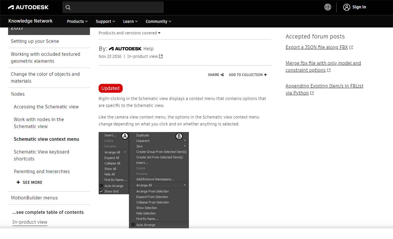

    rachelgomez said:
    Like the camera view context menu
    I don't know which tool you are talking about, but the only "Camera View" I'm aware of in Analyst (part of the AWR tools) - it's not in the Virtuoso Schematic Editor.
  • AurelBuche
    AurelBuche over 4 years ago in reply to Andrew Beckett
    Hi Andrew,
    Again Rachel Gomez answer is completely off-topic...
    It seems like an automated answer (or very weird human behavior)
    Just for the sake of it I typed the answer in Google and found the exact same response on another forum for a completely different software
    https://knowledge.autodesk.com/support/motionbuilder/learn-explore/caas/CloudHelp/cloudhelp/2017/ENU/MotionBuilder/files/GUID-79831650-FD1E-40D2-97E9-172A77EF8E5C-htm.html
    Not sure if this is a bot and why such posts would appear on Cadence SKILL forum but this kind of answers are not helping at all here
    Cheers
    Aurélien
