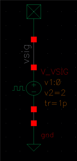

The schematic is very simple, just a square wave generator, connected to net vsig:

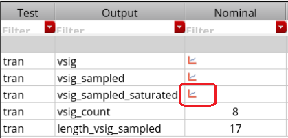

Before invoking comparator(), the following outputs are calculated in Assembler and can be observed on the screenshot below:
vsig = VT("/vsig")
vsig_sampled = value(vsig 0 ?period 5e-07 ?xName "cycle")
comparator() is used in the following output, which gives the error above.
vsig_sampled_saturated = comparator(vsig_sampled 0.5)
When I calculate comparator(vsig_sampled 0.5) in the calculator, I get the error. Could you please help me to find why it doesn't work?

p.s. I made some other observations that are quite strange. First, the results window in Assembler doesn't give any calculation errors for vsig_sampled_saturated. I also don't get an error in CIW.
I get the error if I double click on the waveform to plot or when I calculate it in the calculator.
Second, I use the vsig_sampled_saturated output, which gives an error, in another output expression and the result is correctly calculated (forth output on the above screenshot):
vsig_count = countOccurrence(vsig_sampled_saturated 1)

How can vsig_count be calculated if vsig_sampled_saturated has an error?

    Your functions need to be able to handle families of waveforms as well as waveforms - at the moment, they don't. When plotting something in ADE, it will evaluate with the entire set of results for each signal, and so will see a family - your code needs to always cater for that. See this simple example to see the pattern. I've rewritten your two functions to do this, and used a for loop instead of while. It's also a good idea to create a new vector rather than overwriting the value in place as that can have unintended side effects.
    I think these should work:
