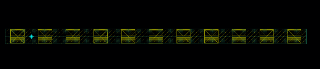

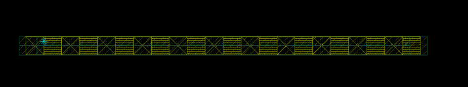

Using the ICADV20.1 ISR 27. and 180nm node. The question is related to the layout XL Auto Via command.
When I use Auto Via command among the Metal1, Metal2 and Metal3, I see that the VIA1 and VIA2 are overlapped.
Is there any option or a way to force auto Via to avoid the stacking vias/overlap. Here is the image
Appreciate your help.
Thanks
Baig

    I tried to edit the constraint group to prevent stack. But it is still not working. As I didn't get any response, it looks like the only option left is to use abe layers to get overlap and move/delete the stacked visa.
    Andrew Beckett over 3 years ago in reply to KSSB
    I wouldn't normally expect there to be any issue with stacking vias in 180nm technology - usually planarized processes don't have a problem - it was only in older technologies where there was no planarization. As such, there seems to be limited support for preventing stacked vias - the stackable constraint (also called viaStackAllowed) is not currently supported by the via engine, and there is some limited support for an alternative (viaStackLimit); this seems to work with changing layers when creating wires, but not by the auto-via. I was going to speak to the R&D team responsible but it's a public holiday for much of Europe today; I would suggest that if this is important you contact customer support as this would allow a change request to be filed on your behalf.
