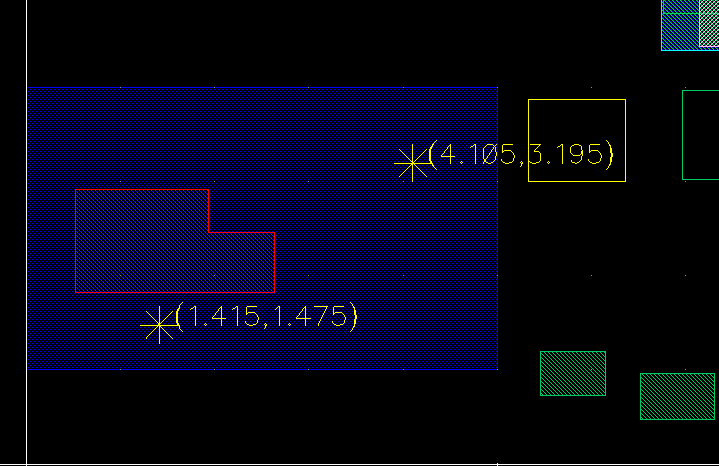

hi,all
I want to display this coordinates,as picture
This method can more conveniently mark the problematic areas, making it easier for me to send the location to my partners
I try to use hiGetCommandPoint() or other function,But none of them can fulfill this requirement. only display in CIW.can not display in layout window.
so I need this code.thank you all. best wishes.
    Andrew Beckett over 1 year ago +1
    This is not a persistent marker, but you can add to the current window (it doesn't save in the database) and then create screenshots, for example. It wasn't clear what you wanted: /* CCFaddCoordHilight…

    Here's what it looks like:
    If you want it persistently saved in the cellView, you could create a figGroup with dbCreateFigGroup, and then use dbCreateLine and dbCreateLabel inside, instead of using the ge.*Hilight functions that I've used here. I'll leave that as an exercise for you...

    Thank you very much for your answer
    You're right, I just want this effect
    My idea is to make a temporary mark (including coordinates), like a ruler, so that when I don't need it, I can shift+k and delete it.
    I need this effect to have a purpose, for example, if there is a DRC error in this area, then I can send it to my partner through this method for him to modify.
