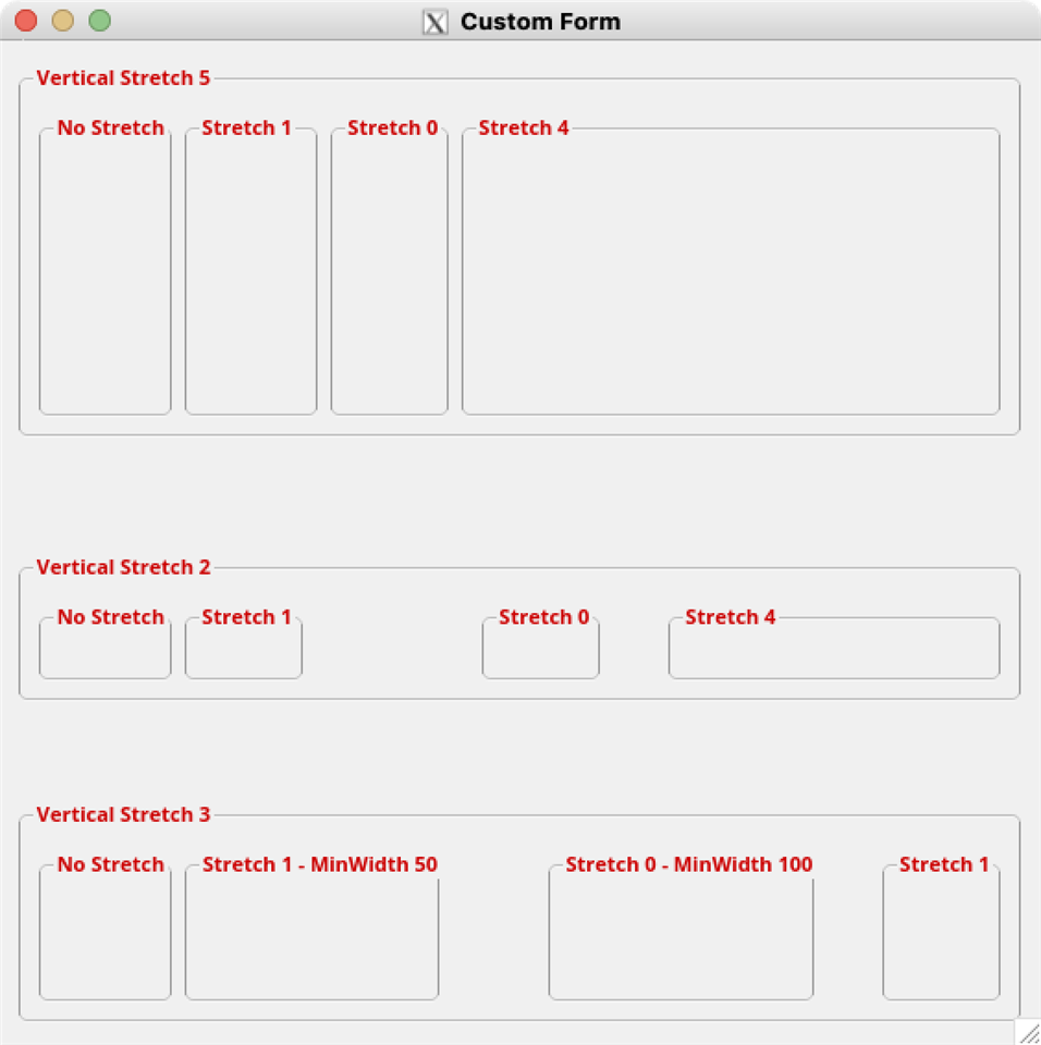

    I made an example of what you can achieve using layout forms with stretch and spacer items.
    The code is a bit dense, but if you load it, you will get a visual feedback and see how stretchiness works.

  • Aurel B
    Aurel B over 1 year ago in reply to RK56
    RK56 said:
    Thanks. Should we mention the min size using pixel counts for hiSetFieldMinSize? That is how I read in the documents which is kind of going back to AppForms.
    Yes, you should provide the same values to hiSetFieldMinSize as you would do for an AppForm.
    But I cannot let you say that it's "kind of going back to AppForms" !
    You can specify the minimum width in case you need it, to correct the display of a field, align some stuff, etc.
    But you don't lose the stretchiness and all the other dynamic parameters that layout forms calculate for you.

  • RK56
    RK56 over 1 year ago in reply to Aurel B
    Thanks Aurel and Andrew. Your code and the comments in those are helpful. I'm getting a hold of these now.
