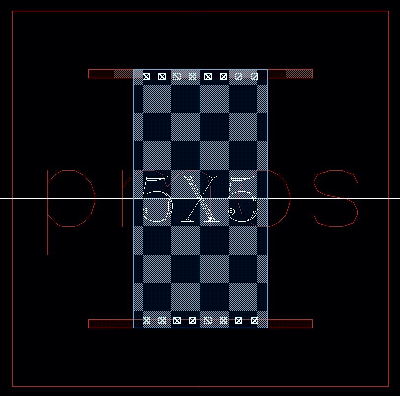

Hello, i am sorry for my English skill.
i am noob for cadence skill language.
As the title says, in window cell view, i want to know point(coordinate) of layer i want
i made a cell named "DECAP" and i placed "DECAP" as mosaic ...
Poly layers is in different hierarchy.
in order to find out all point of Poly layers, i made a script by using skill language...
Script :
wcv = geGetWindowCellView()
overlaps = dbGetTrueOverlaps(wcv wcv~>bBox list("POLY" "drawing") 32 t)

i don't know meaning of (4.2 4.2), (12.2 4.2) ... as result of dbGetInstTransform.
please help me, i want to find out point of poly layer in different hierarhy, in mosaic cell...

    The return value of dbGetInstTransform is the transformation (i.e. offset, rotation, magnification tuple) needed to transform the shape to the top-level. The bit you're missing is to do the transformation…
    Andrew Beckett 10 months ago in reply to Noobnoob +1
    The “point list” you are providing is not a list of point lists but rather a list of bounding boxes. dbPointArrayOr will treat this as a list of point lists, and so each of your bounding boxes will be…

    The return value of dbGetInstTransform is the transformation (i.e. offset, rotation, magnification tuple) needed to transform the shape to the top-level. The bit you're missing is to do the transformation. Rather than appending those lists (which is inefficient and doesn't really help you), you can process the overlaps this way:
    procedure(CCFgetHierPathShape(overlap)
      if(listp(overlap) then
        CCFgetHierPathShape(cadr(overlap))
      else
        overlap
    polyBBoxes=foreach(mapcar overlap overlaps
      dbTransformBBox(
        CCFgetHierPathShape(overlap)~>bBox
        dbGetInstTransform(overlap)
    Note, this is assuming that the shapes are rectangles (if polygons, you'll get the transformed bounding boxes of each shape regardless of the actual shape).

    Noobnoob 10 months ago
    thank you, guys!
    i took a first step for my problem and solved it !!
    as i want, i got a point list.
    next step, i'm going to apply point list to dbPointArrayOr function.
    for example, point_list = ( ((0 0) (5 5)) ((0 5) (5 10)) ((0 10) (5 15)) )
    i think that dbPointArrayOr(wcv point_list)'s result is ( (0 0) (5 15) )
    but, actually, dbPointArrayOr function don't operation.
    what's wrong for me...?
    Thank you for always leaving comments.
    The “point list” you are providing is not a list of point lists but rather a list of bounding boxes. dbPointArrayOr will treat this as a list of point lists, and so each of your bounding boxes will be treated as a two-point diagonal line from the lower left to the upper right, and so you are trying to or three zero-area diagonal lines, and hence the result will be nothing.
    In other words, each point list needs to be the outline of a polygon; if you were starting from the coordinates in a bounding box ((llx lly) (urx ury)) then it would need to be ((llx lly) (urx lly) (urx ury) (llx ury))
