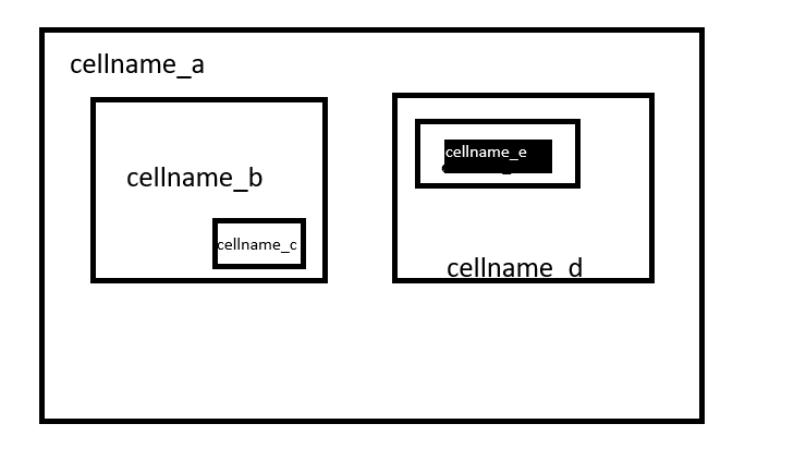

Hi, I want to search a cell used in a top schematic and print the hierarchies of the cell being used, Could you please help? I want to print the hiearchy in terms of cell names not instance names, Thanks in advance.

  • Ganesh B
    Ganesh B 9 months ago in reply to Andrew Beckett
    Hi Andrew,
    Thanks for the reply.   But My requirement was something like this. Could you please help here? Sorry if my description was confusing,
    I want to print the cellname_c hierarchy like "cellname_a:cellname_b: cellname_c".
    Hierarchy for cellname_e should be printed like "cellname_a:cellname_d:cellname_e"
    Thanks,
    Ganesh
  • Ganesh B
    Ganesh B 9 months ago in reply to Ganesh B
    There is 1 predefined functoion "geGetInstHier( getCurrentWindow( ) )" which will print the hierarchy path in terms of instance name, I want to print in terms of cellname.

    I have one query in CCSgetAllHierPaths().
    can we print only the "search cell" hierachy instead of printing all the hoerachy in our design? This will reduce our execution time as well as load.
    Thanks,
    Ganesh
    Andrew Beckett 9 months ago in reply to Ganesh B
    Hi Ganesh,
    I don't understand what you mean by the "search cell" hierarchy. Can you please clarify?
