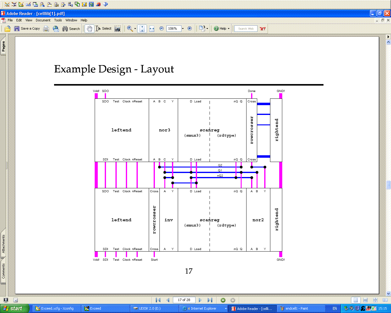

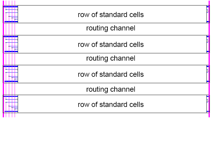

  • Renee
    Renee over 18 years ago
    I finally can upload the picture.
    As shown, the clock signal go vertically into leftend cell, but is distributed horizontally through the overall row, and leftend cells on end of the row will connect to other leftend cells on neighbour rows. For those combinational cells, the clock signal and scan signal will only go straight through them without connection, and those signals will connect by abutment.

  • Kari
    Kari over 18 years ago
     Hi Renee,
    I'm glad the picture uploading is finally working for you! This design looks different than what I'm used to dealing with, but I would think that the small connections (between a left endcap and the one below it) should be handled just fine by nanoRoute. If I understand correctly, you would like the thicker (in the picture, maybe they aren't really thicker than min width) vertical clock routes to be done by SRoute or another automated way. If there are not a lot of these, it may be pretty easy to draw them by hand. Otherwise, I still think you can use addStripe to route them, but it takes some calculating to get the right offsets and spacings.That still leaves the horizontal taps into the vertical clock bus. I would probably let nanoroute attempt these as well. Does it sound like any of this will work for you?
    - Kari

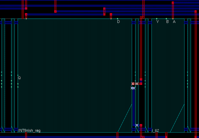

    The nanoRoute did not route the small connection between a left endcap and the one below it. Is it because that I did not provide wide wire to it? As there are not many of these connection, I might connect them by hand.
    About the placement problem, now all the cells can be placed, but although I tried to add filler cells to fill the gap, there is still some gap between cells, and I believed that it is not the problem of the filler cell's width( I did add filler cell before, and there is no problem with it). In my own cell library, the clock, nReset and scan signal go through them horizontally, and for the combinational cells, these signals go straight through without connection, and I want the clock, nReset and scan signal connected by abutment. But, during the placement, it seemed that there was space between each cell, and it cannot be filled by the filler cell.Moreover, there were drc violations for clock, nReset and scan signal's routing.

  • Kari
    Hi Renee,
     In general, if you have nets that are connected ONLY by abutment, then you should put a -skip_routing attribute on them:
    setAttribute -net net1 -skip_routing true
    It's hard to tell from just a picture, but it seems like nano is trying to route your abutment nets, and in doing so, crosses the cells, creating violations. Does that seem like what's going on to you? Do your filler cells continue the clock, nReset, and scan connections? Do you add them before routing? If fillers aren't being added to the gap, and there's nothing blocking them (like routing or placement blockage), then it's usually because you don't have a filler cell that's small enough. But you said they got put in correctly before, so something else may be going on.
    For the other routes (between an endcap and the one below it), was your hand-routing successful? Sometimes trying to route by hand will show the cause of why the router couldn't connect the net.
