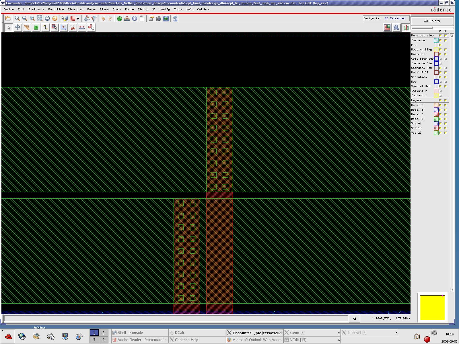

  • kulprashant
    kulprashant over 17 years ago
     Hi kari, thanks for the reply.
    Actually i have misunderstood the dupicate command & as u mentioned i was not able to see the duplicate wire to move the other place.
    Normally for block level i use to while creating the power strap, i use to crate power pins at the boundary
     addStripe -extend_to design_boundary -block_ring_top_layer_limit metal3...............
    In the present design there are lot of pins placed on the bottom side of the core, so some of the pins are coming under power strips.
    so my analog engineer doesnt want to power pins at the boundary, so that it will not create any problem for pin placement (signal pin)..
    to avoid this i have to create the power strips upto the core power rings only as shown in figure and i will create only one pair of VDD /VSS pin manually and which supplies power to the whole design.
    for this i have to increase the core power ring widths on all the side.
    due to only one pin (VDD /VSS) in the design, it doesnot effect the IR drop ???
    Prashant

  • Kari
    Kari over 17 years ago
    Hi Prashant,
     Normally, we avoid placing block pins under power stripes. When creating a block in the top-down partitioning flow, this is easy - you just turn on the switches to make sure pins don't get placed under stripes. When creating a block from the bottom up, it's not as easy I guess. I don't know how big the block is or how many pins we're talking about, but is moving the pins out from under stripes by hand an option?
    Your concern about IR drop is valid! If you only have power coming into your block from one location, as opposed to all the stripes connecting at the next level, then it certainly could be an issue. If your block is pretty small, it may not be. It's hard to say without knowing the design. Will you be doing an IR drop analysis?
