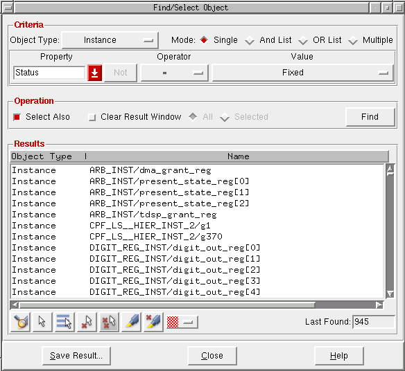

    Option 3: Use "Edit->Find/Select Object"
    This GUI allows for selection by filter, and maps to:
    selectObjByProp Instance <Status>=<Fixed>
