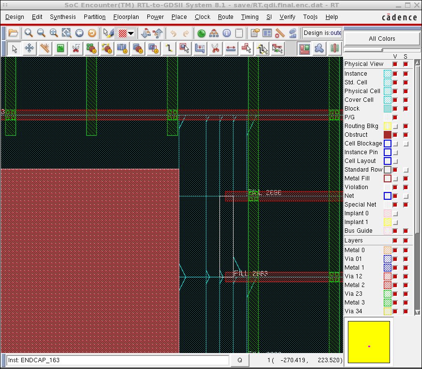

 My design has an area of placement blockage in one corner. In the core rows along this blockage, I get endcaps which are spaced away from the blockage, causing filler cells to eventually be placed at the end of the row, outside the endcap. Is this a problem with my addEndCap, addFiller, or possible addStripe?

    Thanks for looking at it. Here is a quick screen shot.

    BobD over 17 years ago
    Thanks for the picture!
    Boy- it sure looks like the end cap is stopping coincident with where that red horizontal power wire is coming over, doesn't it?  Was the horizontal power in red created with addStripe or sroute?
    I'll be trying each here to see if I can reproduce, but if you let me know it would be helpful.

  • BobD
    No luck reproducing it with a simple placement blockage.
    I'm wondering- what's stopping the power stripes from going over the placement blockage?  The reason I'm wondering is because I'm wondering if there might be a hard macro in the vicinity with either obstructions or power striping or a block halo that's not visible.  Or perhaps a routing blockage present that's not visible.  Or perhaps the block is rectilinear and the cutout is being modeled with a placement blockage?

  • stevemc
    stevemc over 17 years ago
     It is indeed trying to do a cutout in the corner of the block. We represented that as a placement blockage plus routing blockage on all layers. So that's why the stripes don't extend. I did experiment with manually changing those routing blockages to a thin ring (thinking that maybe it was a wide-metal spacing rule), and that didn't help.

  • BobD
    Hi Steve,
    Nice to connect with you on the phone just now. For the benefit of others that might come across this issue, here's what we found:
    First, the placement blockage in the image above (along with a routing blockage that's not visible) is modeling a cutout within a rectilinear block.  We discussed modeling the block as a true rectilinear instead of with a placement and routing obstruction (which the tool supports via the GUI and with the setObjFPlanBoxList command).
    Second, we did some testing and noticed that addEndCap is placing the end cap instances a few microns away from the routing blockage to avoid a drc violation between the metal in the end cap cell and the routing blockage.  However, addFiller does *not* do this, even with "-doDRC true".  This was made particularly obvious because the large routing blockage triggered wider spacing due to width-dependant spacing rules in the tech lef.  This is why filler cells were able to sneak between the placement blockage and the end cap.  I'll look into the inconsistency and report back.
    Further, we noticed a slight difference in terms of how far from the routing blockage addStripe stopped and where addEndCap placed the instance.  I'll also look into this and report back.
    Issue related to wide swaths of routing obstructions are good examples why modeling a block as a true rectilnear.  Steve, if you could report back on how that works out for, that would be great.
    Another approach might be to edit the LEF to remove the larger spacing requirements for wider wires, but it seemed preferrable (to me) to go the rectilinear route because that would enable the horizontal stripes and the end cap cells to be abutted with the rectilinear edge.
    Thanks for raising this issue- it's a great example to learn from.  I'll be following up as I have more information on the points I mentioned.

  • stevemc
     Anurag actually found an option that fixes the issue. The filler cells now always stay inside the endcap.
      setFillerMode -honorPrerouteAsObs true
  • BobD
    Hi Steve,
    Thanks for following up with that information.  I see that effective as well, though I think we could improve the documentation for that option since it doesn't state that routing blockages are considered as if they're equivilent to prerouted nets in terms of how addFiller avoids placing filler cells nearby.  I'll file an enhancement request for the documentation.
    It sounds like this will work well for your situation as long as you're okay with having these end caps and filler cells a few microns away from the routing blockage.  If you (or anyone else) wants the end caps to be right next to the routing blockage, I wouldn't know how to make that happen since addEndCap doesn't have a similar option for arbitrating whether preroutes (or routing blockages in this case) should be treated as placement blockages. I'll file a CCR asking for an improvement in this area as well-addEndCap and addFiller should be aligned in their behavior as your scenario points out.
