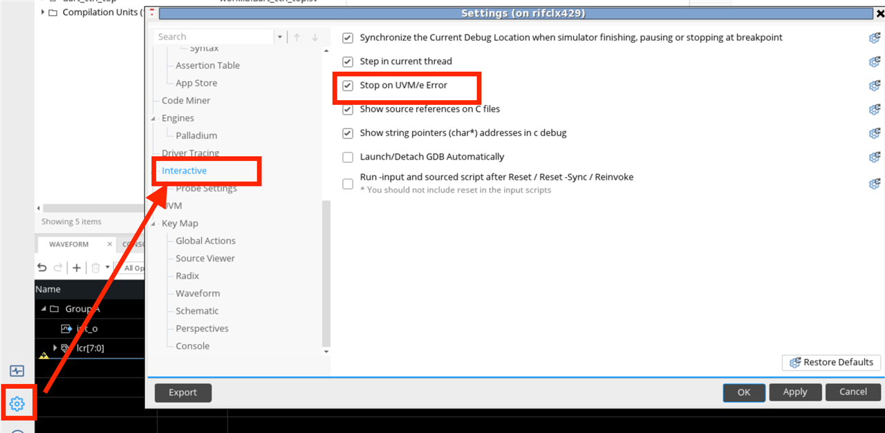

I am running simulation in gui mode using Indago and every time there is UVM_ERROR occur simulation stops. I have to resume it manually. is there any way to disable this feature.

    Doug Koslow over 2 years ago +1
    Hi, Please disable the highlighted setting below to allow the simulation to continue after a UVM error:
