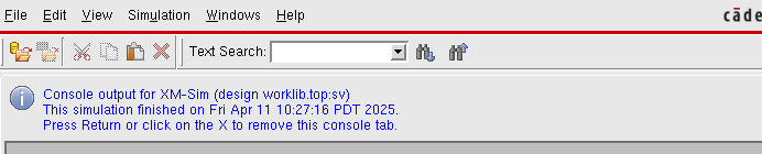

Hello Everyone,
I am trying to run my mixed signal testbench using cadence xcelium. When I try to open the terminal interactively, it says - 'This simulation finished ...'
Please find below screenshot:
Can someone please guide?
Thank you.
Sincerely,
Swetha. C

    Hi Swetha, You probably have run and exit commands in a -input Tcl script that is causing the simulator to exit when you run in interactive debug mode. You can guard that in the Tcl script so they…

    You can also use -tcl command line option to stop the simulation at time 0. Tim

    Hi Swetha,
    You can guard that in the Tcl script so they don't execute when running with SimVision by using the predefined "simvison_attached" Tcl variable like so:
    if {!$simvision_attached} {
      run
      exit
    Please give that a try and see if it addresses the issue.
    Thanks.
    - Doug

    Hi Doug,
    Thank you for your reply. I already have this in my Makefile. The problem was I was facing some convergence issues that I got resolved. Slight smile
