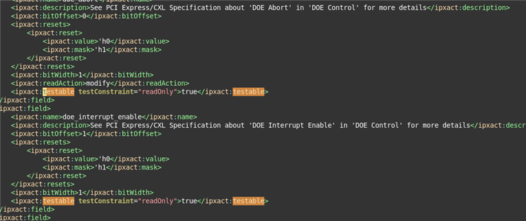

I have added testable and testconstraint attributes to IP-XACT XML. While converting XML to RAL model using reg_verifier tool those attributes ignored and genrated RAL model does not contain these attribute.  Does reg_verifier supports these attributes? its 1685-2014 IPXACT format

    Thanks for providing reg verifier user guide. I have gone through user guide, don't find information that support of testable and testconstraint attributes in reg _verifier..
    Below is the IPXACT XML snippet, applied testable and testconstraint for register field.

    If you need these features to be added to reg_verifier and can explain what functionality reg_verifier is supposed to infer from them, then please submit a formal request via https://support.cadence.com/ - we cannot do this through the public forums.
    I'm not really clear what these attributes are expected to map to in UVM_REG functionality, and it seems that even the IPXACT developers avoided answering the question (https://forums.accellera.org/topic/5830-ip-xact-testable-and-testconstraint/ for example).
