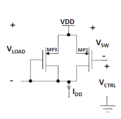

Sir,
   I am new in cadence. I am unable to plot the resistance of a voltage controlled active load like the pic. kindly help me
    Assuming you can sweep the control voltage (e.g. using a dc sweep), you should be able to plot the load voltage and load current. Then you can use Right Mouse Button->Y vs Y on the graph with the load voltage and load current plotted, and pick one of them as the x-axis.
  • Debasish VLSI
    Debasish VLSI over 11 years ago
    It will be kind enough if you give me the detail steps for cadence virtuoso 6.15.Actually I am really unable to plot it properly.
