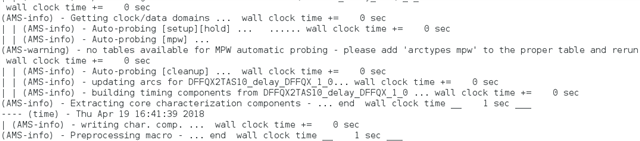

    I'm using Liberate_AMS for characterising an AMS block....Even though my desired arc is getting characterised, the log file is getting filled with the error message attached below:
    I'm attaching the screenshot of the same.
    I'm not aware of what this feature 'Spectre_char_opt' is all about. Where am I inadvertently invoking it ?
    Guys, any help wud b great....
  • Guangjun Cao
    Guangjun Cao over 8 years ago in reply to anandmohan
    Liberate has this variable, spectre_use_char_opt_license, which is a common setting for all Liberate tools. By default it is "1", ie. "on". You can use set_var spectre_use_char_opt_license 0 to turn this off, if you do not have the required license for char_opt feature.
