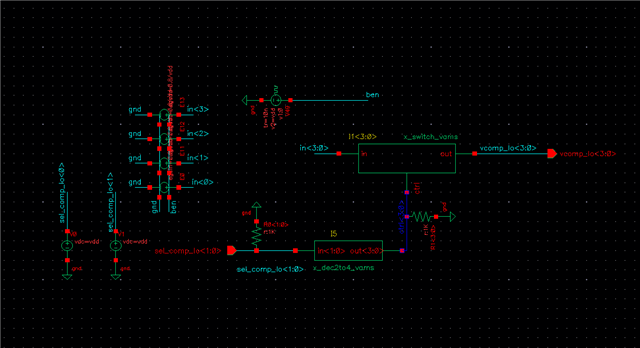

I had a quick question. Is it possible to use a SPICE built in primitive like a vcvs or a vccs in an AMS simulation which has verilog A and verilog AMS modules instantiated? When I try to use a VCVS in a testbench with a verilog a and verilog ams instances I get the following error.
<instance number>  of cell 'vcvs' is a SPICE built in primitive. It cannot be configured to another view like 'External HDL' via Cadence Hierarchy Editor.
    There's no reason why you can't use a vcvs in an AMS simulation (I just tried it and it works fine). It sounds as if you have got some strange binding in the Hierarchy Editor for the vcvs - what do you have the vcvs set to have it's "view to use" (either in the cell table or the instance tree in the hierarchy editor)? Also, just in case it matters, what do you have your Simulation->Netlist and Run options set to in ADE (i.e which netlister; is it UNL, OSS or CellView-Based?)
  • mhkvy4
    mhkvy4 over 8 years ago in reply to Andrew Beckett
    I set the view to use explicitly as spectre in the instance tree view but the editor did find the spectre view for all the elements from analoglib. For the netlist and run options I have selected AMS UNL netlister with xrun ( I thought that was the recommended option to choose). Right now I am having a different error. I am not able to plot voltage signals in a transient analysis and it says " it doesn't evaluate to an object that can be plotted, like a waveform or a parametric wave".  Below is a the schematic capture. The switch and the decoder are both verilog ams instances..

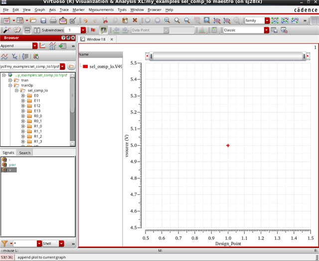

    I opened the psf in the results browser and am trying to see if any of the signals are saved but nothing seems to be plotted vs. time. For example the vpulse instance above( connected to ben net)  has a voltage signal but when I open it up, it plots 5V against some axis labelled Design_Point.

    4. Can you post a picture of the results browser and the plot you're getting? I'd like to see what the signals look like in the results browser

    4) below is the signal for the ben signals which should be a a pulse going from 0 to 5 with delay time of 100n, rise and fall time as 10n, pulse width 1s and period of 2s. The simulation is run for 500ns.
    I selected the tranOp folder in the psf directory and then selected instanced V49 which is the pulse wave source above. There is I, PWR, V signal but no ben net signal.

    4. You're looking at the transient operating point results - which is just the operating point values at the end of the simulation. You should be looking in the tran results to see the transient waveforms. The tranOp will just be a single value per simulation run.

    4) the tran folder seems to be empty so I must be not saving the signals

    Just to let you know that I fixed the issue. I changed the names of the input pins/nets and removed the underscores. When I simulated again using ams I could now see waveforms ( for even the ben signal connected to the vpulse). Don't know why the naming change made it identify all the signals in the setup as ones which can be plotted. Thanks for your help.
