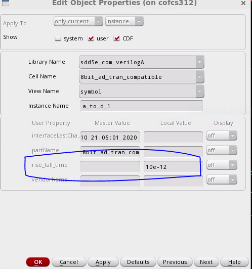

    Did you instantiate this symbol on a Virtuoso schematic? If so, you can change the parameters by doing a query of the symbol and change the defined parameters. For example, in Figure 1, I did a query of a veriloga ADC that has a parameter rise_fall_time. Note that its value is shown as 10e-12. If the cell were editable (this one happens to be read-only), one could change that value from 10e-12.
    Shawn
    Figure 1
    Andrew Beckett over 6 years ago in reply to ShawnLogan
    Shawn,
    Your example is a little odd, as it appears to not have any CDF parameters (normally creating the VerilogA would cause CDF parameters to get created - although you normally have to choose the "CDF Tools Filter" choice on the form to see them).
    Anusha - perhaps you can show a screenshot of what the create instance or edit properties forms look like when instantiating or editing the instance of the genericDAC?

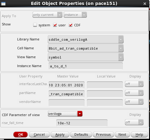

    You are correct. I did not include the option to show the CDF parameter. The updated Figure 1 details the CDF parameter when its view is enabled. Thank you for adding the more illustrative suggestion to the example!
    Shawn
    Figure 1 (updated to include CDF) illustrates the CDF parameter rise_fall_time

  • ShawnLogan
    ShawnLogan over 5 years ago in reply to Anusha Kumar
    Dear Anusha,
    Thank you for letting us know you have are able to change the parameters now - great!
    One note, as Andrew suggested, in the GUI that appears as a result of your symbol query, you have the "Use Tools Filter" view selected. This is a drop down menu and you can select "veriloga" as I did in the updated Figure 1 I posted.
