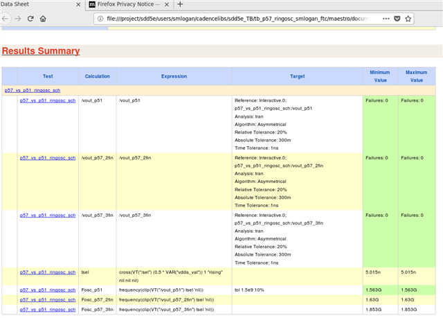

    As some added information..an example of the resulting xml file (data sheet command) with waveform comparison information is shown in Figure 1. It not only contains the waveform comparison pass/fail result, but also the parameters defining the comparison (first three lines under Test column of Figure 1).
    I hope this helps!
    Shawn
