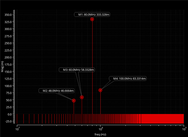

I am trying to measure these on spectrum and please help for.
1) calculator expression to find second/third/foruth maximum power tone from a spectral plot.
Also the frequency bin location of Nth max tone (analogous to xmax for time domain signals)
2) spectral measurement with time. Lets say  have a random signal and want to measure sfdr/hd3/enob etc with time.
I mean with multiple spectral measurements by charging the start time for DFT and finally plot sfdr with time.

    I think if you take a few minutes to think about your request, you will quickly realize that you need to write a custom SKILL or ocean based function. To my knowledge, an existing calculator function can not take the output of its dft() function and interactively scan the result to determine the ordered peak amplitudes and their respective frequencies. Further, as you have not indicated if the tones are integrally related to the sample frequency, their power may extend over several adjacent frequency bins. Hence, the entire power of a given tone is more accurately assessed by integrating over a number of frequency bins and not simply the amplitude of the contents on a single frequency bin. Hence, simply providing the power of a single frequency bin that meets your request may have limited accuracy.
    I do have an ocean procedure that does basically what you are interested, but cannot release the code as it was done for my company. However, I assembled an example using a Virtuoso schematic that generates a sum of sinusoidal tones, performed a transient simulation using a strobe period that includes the dft size to assure the dft() function does not need to interpolate the simulation time domain data. I then used the dft() function to determine its Fourier components. Figure 1 details a plot of the resulting Fourier components. The ocean procedure writes the peak amplitude data to a comma-separated file as well as printing its result to the stdio. Its printed output follows and you will observe that the amplitudes and frequencies it determines correspond to those in Figure 1.

    Tone 48: 46.67 mV at 48.0000 MHz
    Tone 60: 58.33 mV at 60.0000 MHz
    Tone 80: 333.33 mV at 80.0000 MHz
    Tone 100: 83.33 mV at 100.0000 MHz
