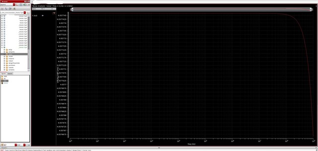

The way the noise is reported by ADE seems to be confusing.
The plot above is the noise output(getdata("/out")) of an RC circuit(1k, 1fF). The spot noise should ve 1.656*10^-17 V^2/Hz but is reported as 4.05 nV^2/Hz. It seems like what is reported is not PSD but sqrt(PSD)

    That's odd - which IC and Spectre sub-versions are you using?
    For me (and I don't recall this being wrong in living memory) it plots in V/sqrt(Hz) (a perfectly reasonable unit for noise as that's often used by analog designers). It looks as if the axes are just labelled wrongly in your case (although the magnitude is slightly off too - in the calculator if you enter sqrt(boltzmann*4*300.152*1k) it will give 4.071E-9 which matches what I see - maybe your temperature is not 27C?)
    I'm using IC6.1.8 ISR18 and SPECTRE19.1 ISR18 in this case (I probably should have switched to SPECTRE20.1 but I forgot to change it). I get the same whether I use the obsolete ADE L, the newer ADE Explorer, or even if I ran standalone from a handwritten spectre netlist and used ViVA to plot the results from the results browser.

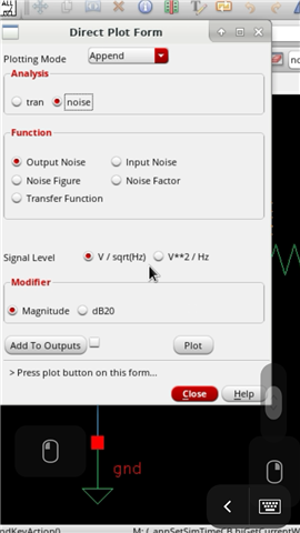

    Dear greywanderer,
    Just to add to Andrew's comment and his nice analysis, if you use the Direct Plot GUI for your noise  analysis, shown in Figure 1, it allows you to plot in either V^2/Hz or V/root_ Hz. The two expressions it optionally adds to your outputs on these two units (not in dB) are:
    V/root_Hz: getData("out" ?result "noise")
    V*2/Hz: (getData("out" ?result "noise")**2)
    When I plot these two expressions in ViVA, I also find the y-axes units are as desired and consistent with the expressions.
    Shawn
    Figure 1

    I just noticed that in the results browser you have a transistor and a resistor - so that circuit is not the same as you described?
    Also, I see you have "outsrc" showing, which suggests to me that you've enabled the "noise separation" option. Ah, if I turn that on, the values are still correct for me (so 4.071nV/sqrt(Hz) but the y-axis units are wrong...). This is a bug. I'll check back with the latest version to see if that bug has been resolved.
    Andrew Beckett over 5 years ago in reply to Andrew Beckett
    It's broken still (with noiseseparation turned on) in the latest Spectre version (20.1 ISR5); the iC version isn't relevant here.
    There's an existing CCR, 2074763, with a couple of duplicates reporting this.
    For now, if you want the units to be correct, run with noise separation turned off.
