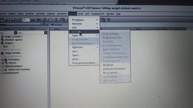

I am unable to do dc node voltage analysis in virtuoso using ADE assembler . Here is the screenshot.
Can somebody please help me?
    The simulation failed, presumably because there's something wrong with the netlist (it is saying that "G0" has too few terminals). Can you show the input netlist (input.scs)? Note - it's better to upload…
    Andrew Beckett over 4 years ago in reply to vshnkmr +1
    In Explorer you can do Simulation->Netlist->Display and it will then show the netlist, and also the path to the netlist will be in the banner of the window displaying the netlist. Regards, Andrew
    The simulation failed, presumably because there's something wrong with the netlist (it is saying that "G0" has too few terminals). Can you show the input netlist (input.scs)? Note - it's better to upload it as a file rather than a screen shot or photo.
    It's hardly surprising that you can't annotate the results if the simulation failed with an error.

    vshnkmr over 4 years ago in reply to vshnkmr
    i am actually working on a virtual machine that is y i uploaded screenshot. i will try to get the file and upload it soon. thank u very much
  • vshnkmr
    vshnkmr over 4 years ago in reply to Andrew Beckett
    I am new to virtuoso can u please tell me where i will find the input.scs file. i am unable to find it.
    Vishnu
