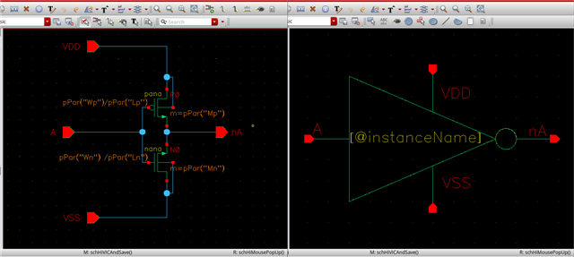

Is it possible to instantiate a schematic inside a verilog-a module?
For example, I would like to create a variable taps ring oscillator, instantiating N tymes an inverter cell that I have defined.
If I simply try to instantiate the inverter I get the following simulation error:
The instance `I' is referencing an undefined model or subcircuit, `inverter'. Either include the file containing the definition of `inverter', or define `inverter' before running the simulation

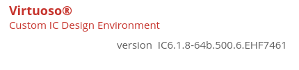

    To find the version of Virtuoso, use Help->About in any Virtuoso window - or type "virtuoso -W" from the UNIX command line, or getVersion(t) in the CIW. For Spectre, this should appear near the top of…

    Which simulator? Which IC and simulator sub-versions are you using?
    No idea, where can I get this information?
    Let me explain in more detail what I have done so far, maybe you can see the flaw in my workflow.
    In my library I have a cell called inverter with a schematic and a symbol. I have also defined some CDF parameters, to easily change the dimensions and the multiplicity of  the transistors.
    I also have the ring_oscillator defined as follow
    // VerilogA for wk_dantecpp, ring_oscillator, veriloga
    `include "constants.vams"
    `include "disciplines.vams"
    module ring_oscillator(VDD,VSS,phi);
    input VDD, VSS;
    output [2:0] phi;
    electrical VDD,VSS;
    electrical [2:0] phi; //output phases of the oscillator
    //inverter instatiations
    inverter I0(VDD,VSS,phi[2],phi[0]);
    inverter I1(VDD,VSS,phi[0],phi[1]);
    inverter I2(VDD,VSS,phi[1],phi[2]);
    endmodule
    Moreover, have defined a ring_oscillator symbol and I have instantiated it in a testbench. When I run the spectre transient simulation I get the following errors:

    To find the version of Virtuoso, use Help->About in any Virtuoso window - or type "virtuoso -W" from the UNIX command line, or getVersion(t) in the CIW. For Spectre, this should appear near the top of the simulation log, or you can type "spectre -W" from the UNIX command line.
