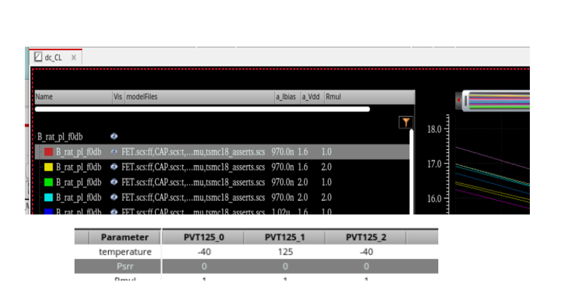

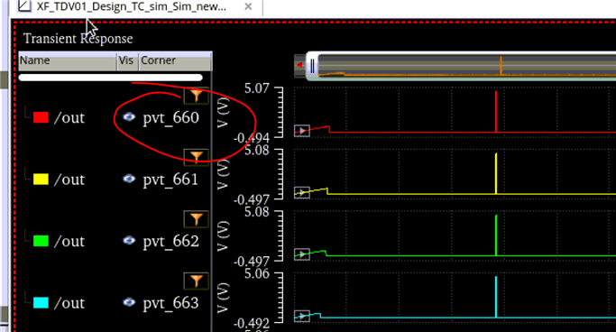

The corner numbers do not appear in a column in the Viva window.
How do I fix this?
first graphic:  corners appearing after "plot across corners"  (copied from co-worker)
second graphic:  result of "plot across corners"   (corners not appearing)

    Also, what is the x-axis on your graph? I'm wondering whether the dimension has been reduced and so the family is no longer the complete corner - some aspect of the corner might be in the x-axis (I'm guessing, since I can't see the entire graph). Your colleague is plotting a signal, whereas you appear to be plotting an expression of some sort (what is the expression?)

    Now I have a plot of a voltage signal, same results file. "Corner" still not appearing in menu.
    Andrew Beckett over 4 years ago in reply to bnevins
    Are you plotting from a plotting template? If so, there was an issue where the Corner name went missing from the legend which was fixed in IC6.1.8-64b.500.17 (i.e. the sub-version one later than the one you're using).
    If it's not that, I would suggest trying again with the latest hotfix (ISR25 - i.e. with .25 at the end) and if it's still not working, contact customer support. I think it would need some more detailed investigation by one of the team.
