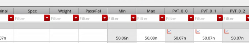

i want to know if we could increase the Precision in cadence?
Hagar Hendy
Hagar Hendy over 3 years ago
Here are some value, and i want to know if we could increase the Precision in cadence, more than 2 digits?

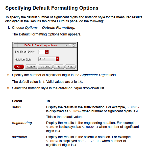

    Dear Hagar Hendy, DI you try this?

    Also, if you want to control this differently for each output, there is a digits column on the Outputs Setup tab where you can set the significant digits (say to 8). Note that both this and the global…

    Dear Hagar Hendy,
    DI you try this?
    Andrew Beckett over 3 years ago in reply to ShawnLogan
    Also, if you want to control this differently for each output, there is a digits column on the Outputs Setup tab where you can set the significant digits (say to 8). Note that both this and the global setting that Shawn mentioned control the number of significant digits (not the number of decimal places after the point). So your example is showing to 4 significant digits (the default).
