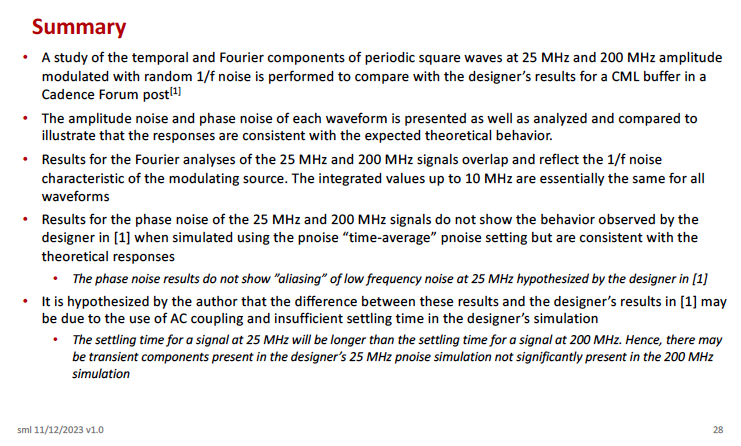

  • ShawnLogan
    ShawnLogan over 3 years ago in reply to ShawnLogan
    Dear Vinod,
    I remained puzzled about your time-averaged pnoise result. Therefore, I took some time to study amplitude modulated periodic square waves at 25 MHz and 200 MHz  amplitude modulated by a 1/f random noise source. The study of the Fourier components of the waveforms and their respective phase noise and jitter is consistent with my understanding and not consistent with your simulation results. The note is at:
    I cannot post the item without it being classified as spam. However, you may cut and paste the following in your browser if you are interested. The summary, page 28, is attached to save you some time if you do happen to be interested.
    1drv.ms/b/
    s!AnM-GsAEZPoSr1O_-tIAqe5JG-zv?e=yKAW5I
    Shawn
