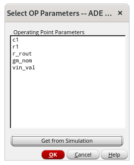

    You can do this in ADE by using Outputs->Add->Op Parameters. This will add a row to your outputs in ADE and there are two "..." buttons. The first selects the instance - you might find if you do this that it won't let you select the instance - it might say:
    *Warning* object selected is not a valid selection object
    This is because there are some checks in there which try to see whether this is a primitive element or not, and this can get confused if you have both a schematic and a veriloga model. So you might need to type in the instance name (for example "/I7"). Then the second "..." allows you to pick the "parameters" to save (which will be any of the variables). For example, within in my Verilog-A model:
    parameter real pole_sec = 18.0M;
    real c1, r1;
    real r_rout,gm_nom, vin_val;
    real vmax_in_p, vmax_in_n, iin_max_p, iin_max_n;
    electrical cout, vref;
    electrical c2;
    If I press the "Get from simulation" button it shows this:
    I can then select the variables I want to save for this instance. Or I could just type them into the second entry box. By the way, if you were wondering why some were omitted (the last line of variables in my model) - this is because they were declared but never used - so there was nothing to save from the simulator.

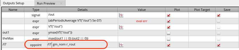

    I tried the above. However, the 'Get from Simulation' button doesnt populate the variables for me. So I tried adding it manually. However, it allows me to enter only 1 variable. The moment I enter a 2nd oppoint variable to the Outputs, it replaces the old oppoint variable. Is there something that I'm missing.
    Andrew Beckett 11 months ago in reply to PE202503078250
    Add the variables space-separated like this;
