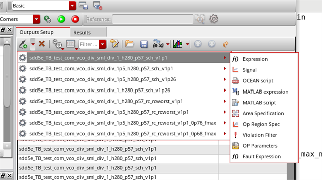

Hello,after plotting gm_id vs Vgs ,wen i tried to get another parameter it shows me a list of one parameter as shown bellow.
Where did i go wrong?
Thanks
    It will only list the parameters you saved (via the Outputs->To be Saved->Select OP Parameters). Presumably you didn't save them all?
    Some PDKs might have subckt models and only make available certain parameters, but this is gpdk045 and so that shouldn't be the case.

    Hello Andrew,its not ADEL i am using assembler calculator.
    I only press the OS button and it shows me the circcuit and i click the nmos and get the list.
    how can i so it with the calculator menu in assembler?
    Thanks
    Andrew Beckett over 5 years ago in reply to robert 21
    This is nothing to do with whether it's ADE L or Assembler. If you didn't save it, the OS function can't retrieve it as there's nothing to retrieve!

    Hello Andrew ,Where is the Outputs menu in assmbler so i could do Outputs->To be Saved->Select OP Parameters ?
    my gol is to click the nmos and see the full list .

    Dear robert21
    In the screenshot you detailed in your just posted comment, please go to the "Outputs Setup" tab and using your mouse, point and click on the oscilloscope probe just above the "+" tab with the green background. This will allow you to add an output or waveform expression or other element as an output to a particular test (see Figure 1). Alternately, drop down to Explorer from your current Assembler test and you will locate the , perhaps more familiar to you, "Outputs" menu.
    Shawn
    Figure 1.
    The equivalent in Assembler is the menu that Shawn pointed too - it's the "OP Parameters" choice, but hitting the down-arrow next to the test name would take you to Explorer for that test, and then. you can use the menu I described (which is the same in Explorer and ADE L)
