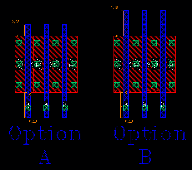

Greetings,
I hope we are all learning and growing together. I would like to share some thoughts on the concept and concerns related to the Poly-Endcap in CMOS layouts ( Option A) when both sides are considered under ideal conditions.
Option A (ideal conditions) & Option B ( Non ideal conditions)
Now, let's examine the situation when the Poly-Endcap is not the same in a CMOS layout ( Option B) under non-ideal conditions on both sides.
Could you please share your insights on the implications if the Poly-Endcap differs in high-speed or RF layouts?
Specifically, I’m interested in the potential impacts on performance and fabrication at lower technology nodes. I have attached the CMOS layout in this email (ideal & non-Ideal condition).
Thank you!

    Answer to the above post by the Foundry expert :
    Poly-endcap should be the same for matched transistors because it directly affects effective channel length and parasitics — mismatched endcaps break device symmetry and worsen mismatch. Staggered diffusion contacts for high-speed signal switching with low capacitance
