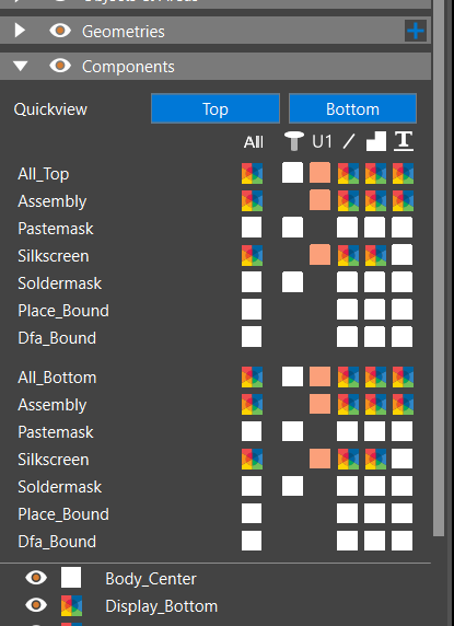

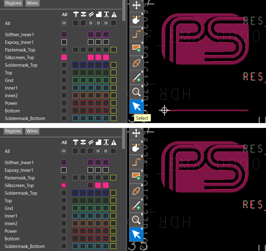

If I draw a line on the silkscreen layer... it puts it on the board silk subclass.  I can't turn this subclass on and off in Presto.  I can only turn on and off the component silk subclass.
Is this for real?  Do I need to go into the legacy tool to turn on my subclasses and then go back to Presto?
Anyone know how to turn on subclasses that don't seem to be there in Presto?  Why has presto been out for like 2-3 years and we still don't have basic color stuff????
Thanks

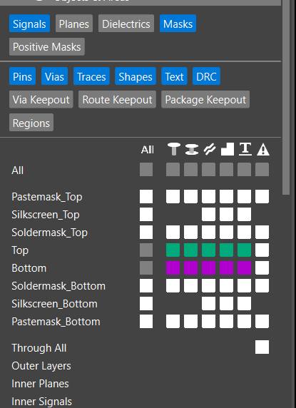

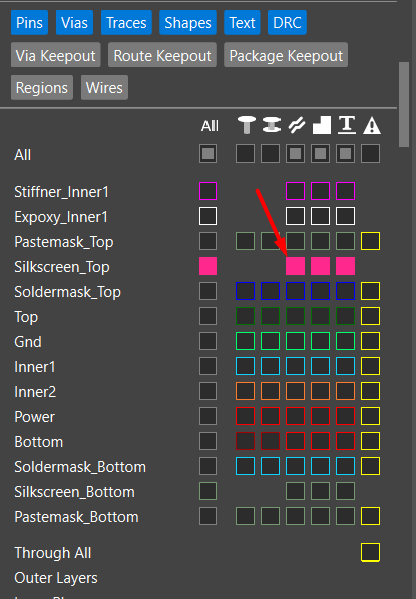

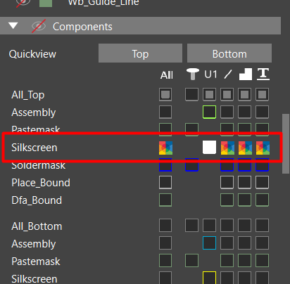

    Hi DG202504226528
    It is true that drawing a line in a silkscreen class defaults to the board geometry / silkscreen subclass. However, you CAN control its visibility here:
    See this:
    All the class/subclasses can be controlled either in this section or in the following one:

    It would if I  had the same color things as shown in your images.  I don't have "silk" or "paste" or "soldermask" or any of that cool subclass stuff.  I only have those for the "components" class.
    What license are you running?  Allegro?  Cause my Orcad Prof license doesn't seem to show those.  Unless that's another thing that should be on by default and isn't.
    Anyone know how to turn on these layers in my color thing?
    Anyone have like a cheat sheet with settings, etc to set up in Presto to turn like everything on?  Am I missing something and Presto actually has more capabilities than I thought?
    Thanks.

    That's strange because when I open a new board in Presto, I can still see all these subclasses and controls. I haven't tried adding information to them (which might be what's behind the legacy tool wall) but definitely you can view and get all the visibility controls I showed you above.

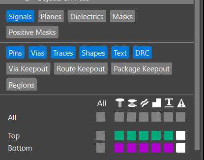

    Is it because maybe you have them filtered out like this?
    In the above screenshot you can see that only the Signals filter is ON. If you want to see all the other layers, you need to activate them:
    Specifically, the one that matters is the Masks filter. The weird thing is that you can't filter out these subclasses in the Component section. Here it's always there. You should be able to see it:

    0 DG202504226528 over 1 year ago in reply to JuanCR
    Nope, that's not it.  I have all the filtering on, etc.
    I'd add a screenshot, but this forum has all sorts or weirdo rules for adding an image... Feels a lot like Preto ;) haha.
    I do have all my layers now that I added silk, mask, paste to the stackup manager.  If Presto is geared to steal Altium users... there's a lot of work left for that to happen.
